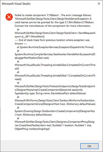

    I have installed the ComponentOne Nuget Packet for .NET Core 6.0.
    But when I place the control on to the form the error show as following:
  • Posted 8 August 2023, 8:59 pm EST
    Anyone can help me on this. I could not test Controls on .NET CORE 6.0

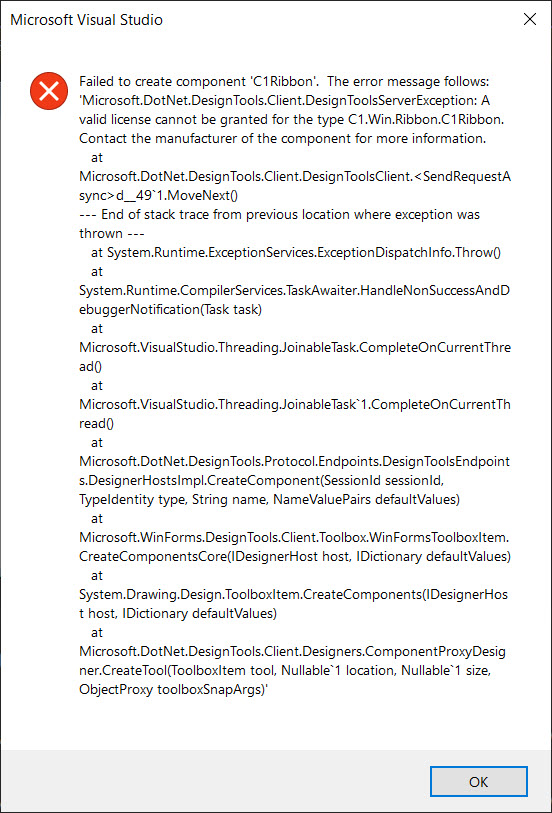

    Hi Kartik,
    My one still pop-up with the following:
    Any idea.
    Duyet Le

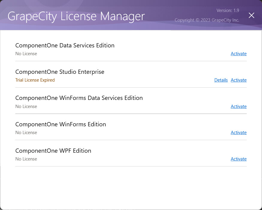

  • Posted 9 August 2023, 2:34 am EST
    Hi Duyet,
    FYI, the 30-day free trial period can only be used once on a machine. In your screenshot, the GrapeCity License Manager utility says “Trial License Expired”, which means that this machine has already exhausted the 30-day trial period before.
    Now, to further use the C1 controls, you will need to purchase and activate a license key in your system. For more details related to the purchase, you can contact the sales team at:
