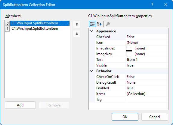

    Now open the .NET6 form in designer and edit the items:
    You will see that the items don’t have a property “Name”:
    Now make any change to the form, e.g. change the location of the C1SplitButton. Save the form.
