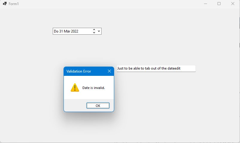

    This does not work - whenever you type in a date (e.g. “31 3 2022”) and tab out of the control, a validation error is shown:

    OK, I think I found a workaround for the validation problem.
    And by digging through the code of “PostValidation.ValidateValuesAndIntervals”, I think I also found the reason/bug in C1DateEdit: this seems to happen only on non english cultures.
    Here are the relevant code parts:
            IComparable comparable = (IComparable)Convert.ChangeType(value, ItemType, f.get_CultureInfo());
            for (int l = 0; l < Intervals.Count; l++)
              ValueInterval valueInterval = Intervals[l];
              if ((!valueInterval.UseMinValue || ((!valueInterval.IncludeMin || comparable.CompareTo(valueInterval.MinValue) >= 0) && (valueInterval.IncludeMin || comparable.CompareTo(valueInterval.MinValue) > 0))) && (!valueInterval.UseMaxValue || ((!valueInterval.IncludeMax || comparable.CompareTo(valueInterval.MaxValue) <= 0) && (valueInterval.IncludeMax || comparable.CompareTo(valueInterval.MaxValue) < 0))))
                return true;
    “Convert.ChangeType” will result in a string like “31.03.2022 00:00:00” when entering the date “31st march 2022”.
    The “MinValue” and “MaxValue” of the interval contain the strings “01.01.1753” and “30.12.9998” (when using range build from DateTime objects as done in my initial sample - in the current workaround I used string ranges in english format).
    Calling “compareTo” on those string does not work at all.
    My workaround: specify PostValidationIntervals in english format (“1753-01-01” and “9998-12-31”).
