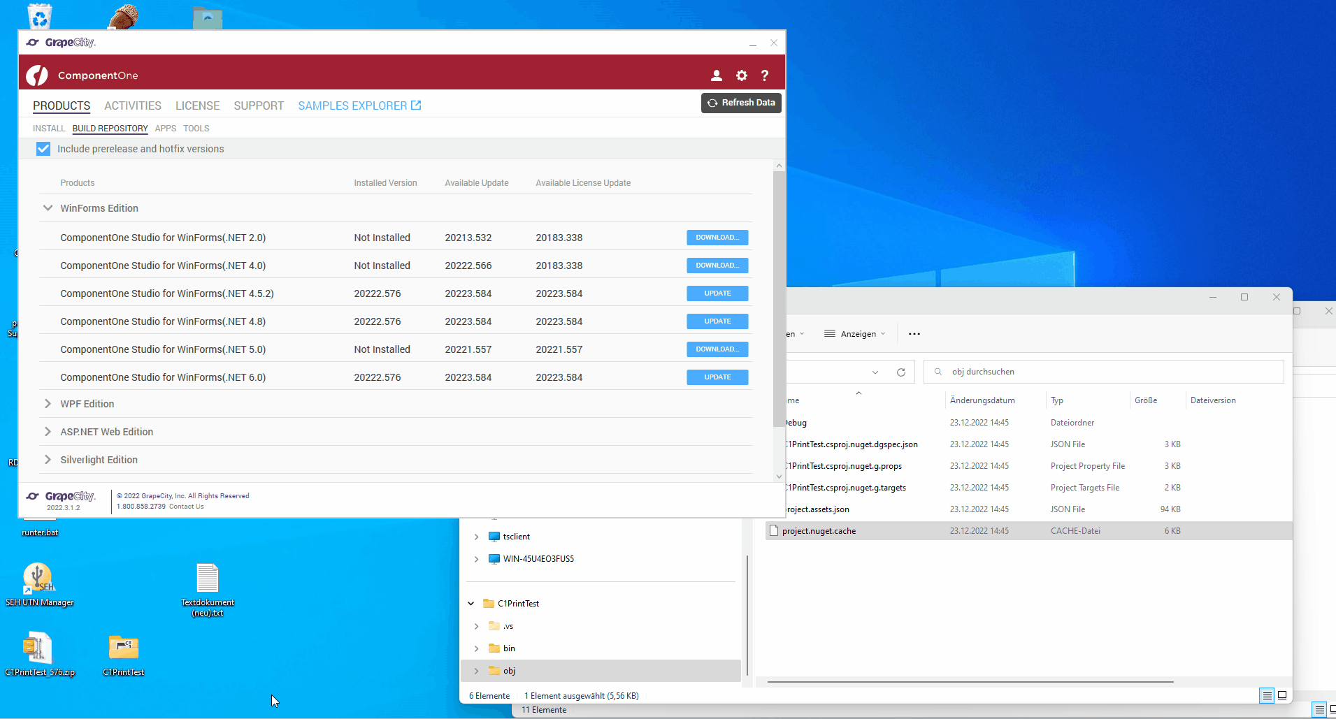

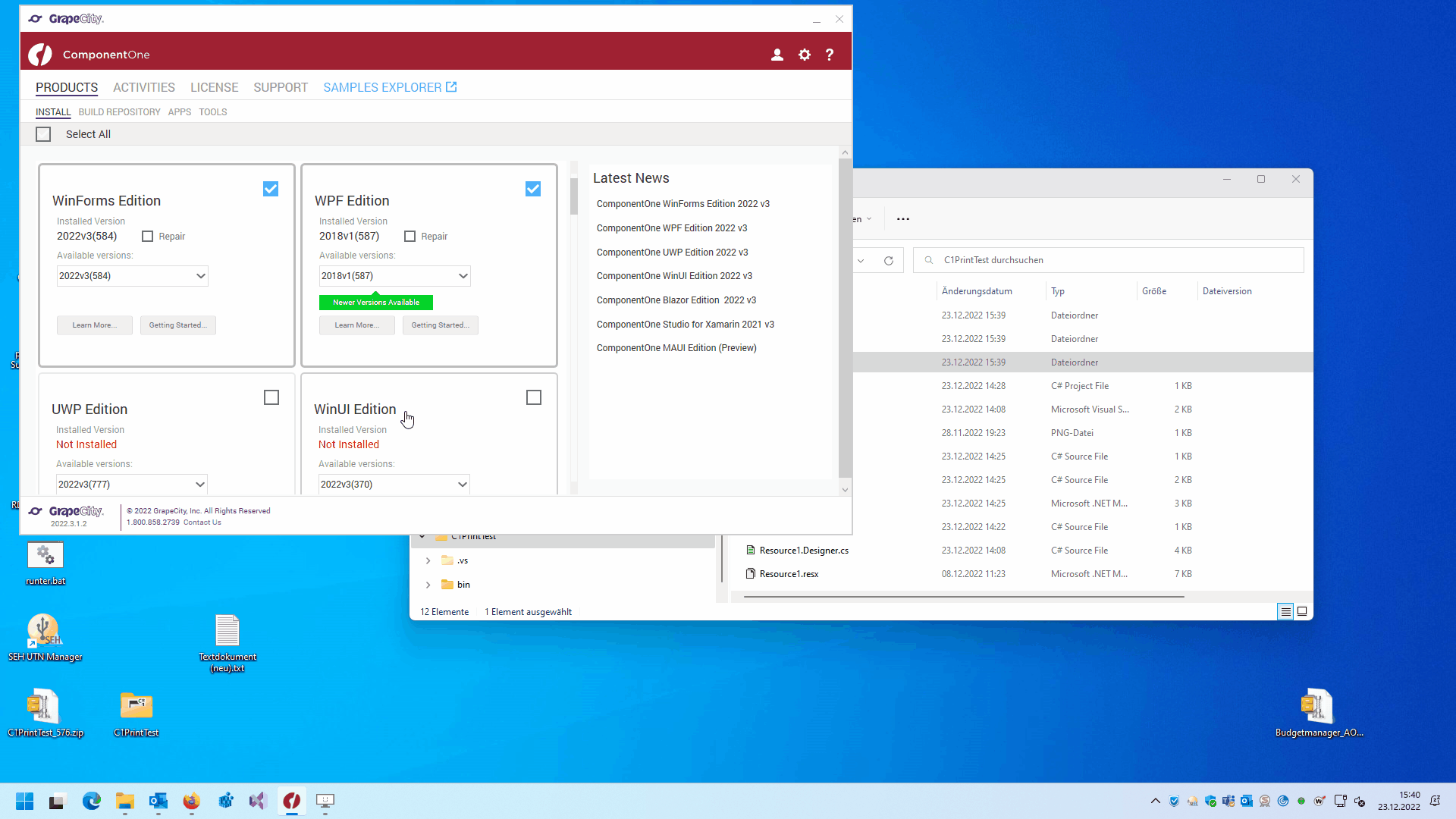

  • Posted 23 December 2022, 10:51 am EST - Updated 23 December 2022, 10:56 am EST
    I can reproduce it, and I think I know why you could reproduce it only a few times: it will not happen if your local Nuget cache contains “C:\Users\USERNAME.nuget\packages\c1.win.printing\6.0.20222.576”. I just noticed that for me, this directory was created one day after my initial bug report. So, Visual Studio/Nuget picked the files from somewhere else (maybe from the cache in “C:\Program Files (x86)\ComponentOne\Packages”?), instead of downloading them from Nuget central.
    Attached is a modified sample with some cleanup, and it really uses C1PrintDocument now ;-): C1PrintTest_576.zip
    Here are the first few steps to prepare the issue:
    C1 .576 is installed, and I open the solution and build it. Then I show “obj\project.nuget.cache”. The final step is that I show my Nuget cache, where I renamed the old dir “6.0.20222.576” to “6.0.20222.5760” to show that it is not downloaded.
    And here are the final steps:
    After installation .584, I prove that “obj\project.nuget.cache” still contains the old path, then I open VS and build the solution => the error occurs.
    Hope this makes it reproduceable for you. The important step seems to be to remove .576 from your local Nuget repository before compiling with .576 installed.
