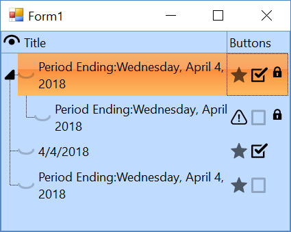

    With a fixed width treeview column, is there a setting for a CustomContentPresenter for a text item that would re-wordwrap the text if:
    1. the user resizes the column
    2. the item is a child of the the node
      If I set both AutoWidth and AutoHeight properties for the TextElement and the RowPanel it sits in, the parent node renders correctly but the child cuts off part of the text.

    about first question, try set Style.WorWrap property of TextElement as true.
    var e = new TextElement();
    e.Style = new Style();
    e.Style.WordWrap = true;
