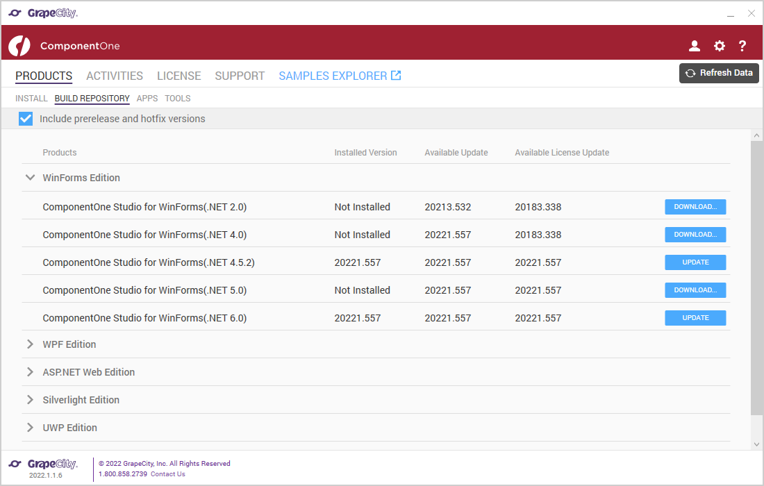

    Thanks for the clarification. As our application uses already 4.8, I will upgrade to the new version soon.
    It seems there is no installer available. The ComponentOneControlPanel did not provide me an option to pick the 4.8 components:
    As our application does not use NuGet packages, I need the files locally installed on my machine.
    But I found the dlls on the prerelease site, so I worked around the missing installer: https://prerelease.componentone.com/hotfix
  • Posted 31 May 2022, 4:44 am EST
    Hi Wolfgang,
    The .NET FW 4.8 C1 controls will be available for download through ComponentOne Control Panel starting from the 2022v2 release.
