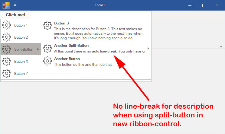

    we have changed our project from Classic Ribbon to the new control in the last days.
    In the process, we noticed in the application menu that there is no automatic line-break for descriptions of split-buttons, as is the case with normal buttons, for example.
    Is there a special property for this or is there still a small error here?

  • Posted 29 December 2021, 6:50 am EST
    We have escalated the issue to the development team and will let you know when we have an update.
    [Tracking ID : C1WIN-26439]
    Avnish
  • Posted 26 May 2022, 12:22 am EST
    The issue has been fixed in the latest 2022v1 Hotfix release. Please update to the latest release and let us know if you face any issues.
