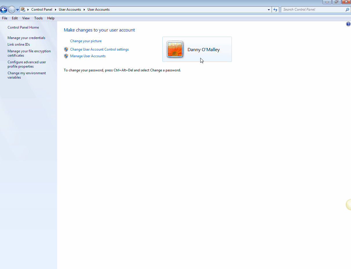

    This issue is easy to duplicate on our end. I’m attaching a simple project that exhibits the same behavior. When run with an account that does not have special characters in the name, it runs properly, and when run with one that does contain a special character, it crashes.
    1. Create an Additional Windows user on the computer with an apostrophe included in the name. In my example, I’ve used “Danny O’Malley” for my testing. I gave Danny administrative permissions on the machine so that I could easily access the project location; however, the user also exhibits the same issue with Standard permissions.
    2. Create a simple VB.Net Windows Forms project targeting .Net 2.0. Include a reference to the C1Editor component for .Net 2.0, and add a C1Editor control to the Form.
    3. Run the project using the normal windows account and verify it runs appropriately.
    4. Switch users to the new account you created with the apostrophe. Run the project. The compiled executable for the project I attached crashes on our system when run under these conditions.

    Thank you for providing the sample application and the detailed explanation.
    However, we are sorry to mention but we could not replicate the issue at our end using the given sample and the user account name.
    Please refer to the attached video demonstrating the behavior at our end.
    Therefore, we would request you to please share the exact environment details of the system in which you can replicate the issue. So, it would be helpful for us in reproducing the same at our end and assisting you further accordingly.
    Arpit Jain
    2015/05/avi_C1EditorTest.gif

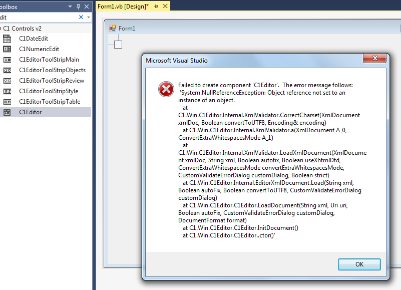

    I’m also seeing issues when simply adding the control to a VB.Net Windows Form when logged in with the account with the apostrophe in it. When doing so, the attached error message is displayed. Previously, we’d created the test project in the account that contains no apostrophe, and running it in the other caused the crash. Now when assembling the project in the “Danny O’Malley” account, it pops up the same stack trace error when adding the C1Editor control to a VB.Net form.
