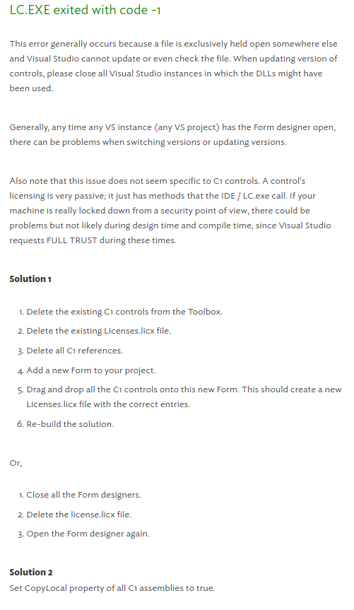

    Please follow the given blog link:
    http://our.componentone.com/2015/06/08/a-step-ahead-troubleshooting-common-errors-part-ii/
    I have also attached an image for your reference. Hope it helps you.
    Meenakshi
