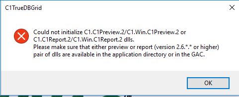

    I am currently using Visual Studio 2017 with WinForms (4.0.20181.296). In the past (VS2015 Winforms(4.0.20172.271)) I was able to print from a TrueDBGrid using the .printpreview method. Now I get
    I have no .2 files in my project. I also cannot find a C1.C1Preview.2 or C1.Win.C1Preview.2 in the WinForms /bin.
    This worked in the past with no additional files. Please advise.

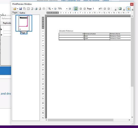

  • Posted 29 March 2018, 12:51 am EST - Updated 4 October 2022, 1:26 am EST
    Issue is not reproducible at my end with your application. It works fine. Please refer the attached image. It seems to some installation problem on your system. Are you using “C1Live” to update the C1Studio. Could you please replace the all C1 dlls present in “C:\Program Files (x86)\ComponentOne\ASP.NET Web Forms Edition\bin\v4” folder with latest dlls present in “C:\Program Files (x86)\ComponentOne\WinForms Edition\bin\v4.0”
    Hope it helps.
  • Posted 29 March 2018, 11:05 am EST
