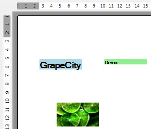

    Hallo Prabhat,
    your sample shows exactly my problem. The output of the console is:
    Height = auto, Width = 5cm
    5cm
    1. It did not show the height, only “auto”! Both texts are top aligned. I will write bottom aligned. What can I do to write both text bottom aligned?
    2. Also I want to get the height of a RenderRichText Object.
    Thank you for your answer
    Regards and greeting from germany
    Jürgen

    By default, the height of each RenderObject is ‘Auto’. This means that the object’s size is calculated according to its content. So you cannot get the actual height value. Please refer to following documentation link for information on RenderObject’s size and location behavior:
    https://www.grapecity.com/componentone/docs/win/online-report/specifyingrenderobje.html
    To set the alighnmemt of the text in the RenderText use the TextAlignHorz and TextAlignVert property as given below:
    rt1.Style.TextAlignHorz = AlignHorzEnum.Left;
    rt1.Style.TextAlignVert = AlignVertEnum.Bottom;
