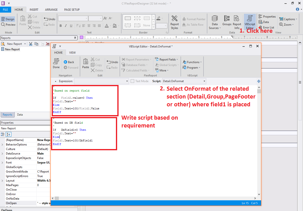

    I’m very new in using C1 FlexReport (v4.0.20171.248) and I’m in the process of converting 100’s of reports from another third party report designer. The other designer has an option in their formatting options for numbers which is “suppress is not a number”; which is basically a way to prevent errors from divide by zero. It seems in FlexReport that it shows the infinity symbol when this situation occurs - is there any way that I can get it, to NOT show the infinity symbol - as our users are more used to seeing a blank/space than the symbol ?
    Cheers,
    Chris.
  • Posted 27 September 2017, 9:13 pm EST
    For achieving your requirement, you need to write script on the OnFormat or OnPrint property of the related section in which your field is placed.
    'Based on data base field
    If [DbField] = 0 Then
    Field1.Text=""
    Else
    Field1.Text=100/DbField
    EndIf
    Please see the attached image for complete implementation.
    Hope, it clarifies.
    Sonu
