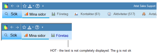

    When a tab is under the “hot” cursor, not all letter are shown correctly.
    I have tested a lot of settings in the C1ThemeDesigner.
    Default font is Microsoft Sans Serif; 9.75
    Hot font is Microsoft Sans Serif; 9.75; Bold
    The lower parts of the g is not shown when the font is bold.
    Which settings do apply to this?

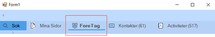

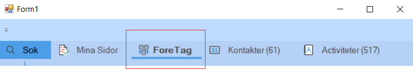

    Thank you for sharing the details and screenshot. We tested the behavior you mentioned with the latest version (4.8.20232.611), but we could not reproduce it on our end. Please see the attached sample project and screenshot for reference.
    It might be possible that the height of the “tab header” area is not sufficient to fit the Bold text you are setting. To customize its height, you can use the C1Ribbon.RibbonStyle property.
    c1Ribbon1.RibbonStyle.ConstSet[StyleConst.TabAreaHeight] = 40;
    If you still face the issue, please provide a sample project or update the attached project to reproduce the issue, so we can investigate further and assist you in the best way possible.

    Hi, tested but to no change.
    I have included my theme.
    Please find out what it is that produces this error.
    //Peter
