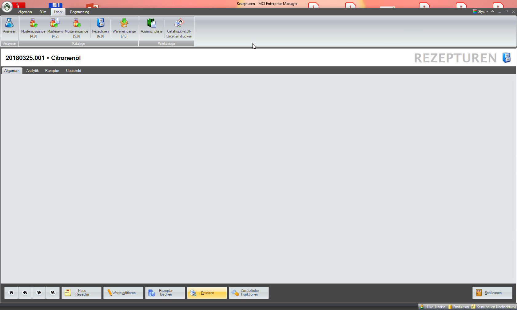

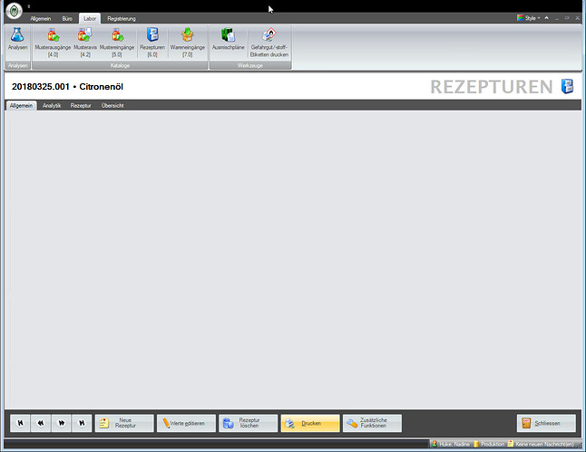

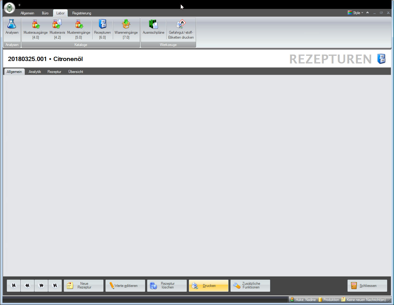

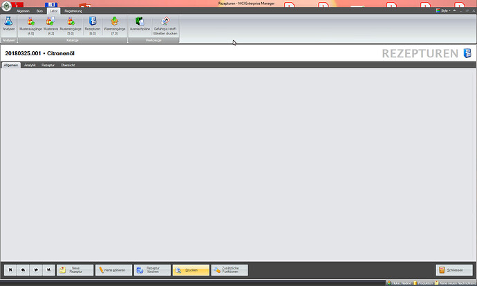

    I would add two screenshots of how the MDI-Window looks after opening and canceling an open- or save-dialog: Window-top gets transparent and control-box for closing, maximizing and so on disappears. Please see attachment named “Maximized.jpg”.
    First I thought it’s a (re-)drawing-issue, so I give the advise to turn to normal window-state and than back to maximized. But that didn’t help. See also attachment named “Normal.jpg”.
    Using newest drivers for Intel 4600 Graphics or Nvidia GeForce didn’t make any difference on this. Problem stays.
    As said by mhamilton, problem is only on machines with Windows 10 (Build 1809).
