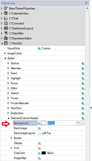

    Here is a snippet from our code. We use it to modify the C1FlexGrid.Styles.SelectedColumnHeader backcolor.
    Though this is not your requirement, it hopefully gives a hint.
    C1Theme theme = C1ThemeController.GetThemeByName("Office2010Silver", true;
    BackgroundProp propHeader = (BackgroundProp)this.theme.Children.GetItemByPath("C1FlexGrid\\Styles\\SelectedColumnHeader\\Background");
    propHeader.Value = new ThemeSolidBackground(Color.Khaki);
    The argument to “theme.Children.GetItemByPath” is a path that can found in the C1ThemeDesigner (“C:\Program Files (x86)\ComponentOne\Apps\v4.5.2\C1ThemeDesigner.4.5.2.exe”):
    So, you have to identify the path that points to the properties you want to modify. The theme lightness seems to be found at “C1Ribbon\Palette\ThemeLightness”.
