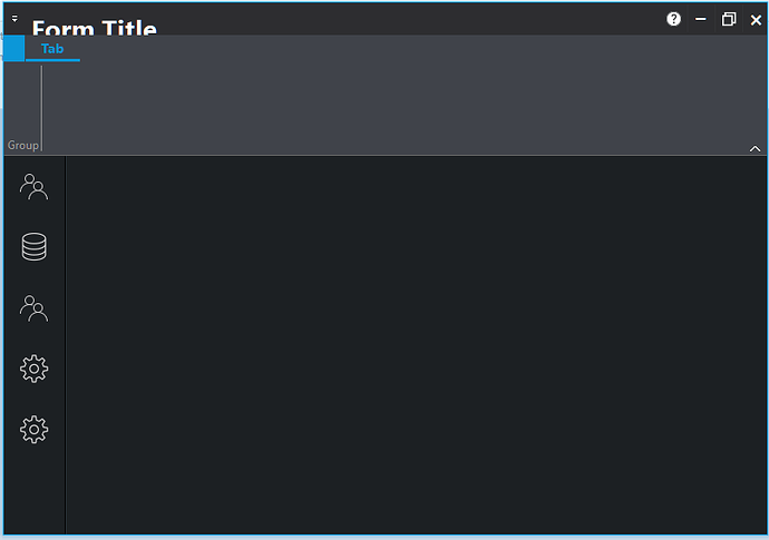

    If I set the font to size 10 or bigger into form, i can see this issue and I have NO WAY to modify the text alignment
    How can set the “vertical alignment”? Don’t answer me “reduce font”, please…
    I need 20 point size font
