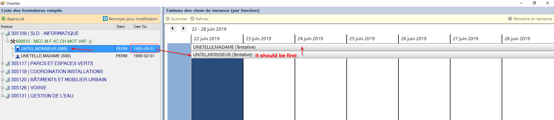

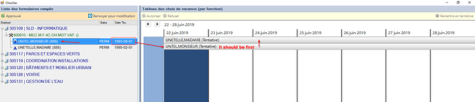

    Is there a way to force the order that the appointment are Stacked when using multiple owner in one scheduler
    For exemple we need to show the allday appointment order by the birthDate of the owner that made the choice.
    For example :
    1- Mr. A born 1975-01-05 creates an appointment for a week off (04/02/2019 to 09/02/2019)
    2- Mr. B born 1986-02-01 creates the same appointment
    I need to be sure that the stacking of all appointment will be ordered by the birthdate of the owner

    You should use C1Schedule.AppointmentComparison property.
    Please refer attached sample.
