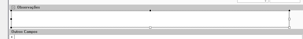

    Is it possible for an InputTextBox (using multiline property to true) inside an InputPanel to have ScrollBar? I needed a vertical scrollbar.
