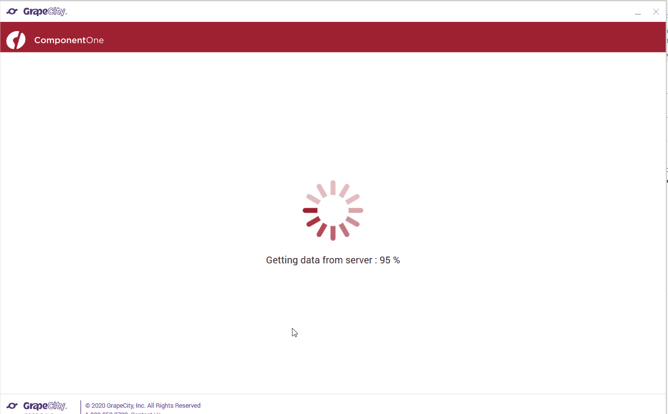

    To download any version of control you can always use the Build Repository tab on the C1ControlPanel. Please follow the steps shown in the GIF attached to update or Download Zip for any version of controls. Since 4.5.20202.450 is a Hotfix Release you need to check the “Include Prerelease and HotFix versions” option for it to show in the Builds list.
    If you need further assistance, please let me know.
  • Posted 10 December 2020, 7:21 am EST
    Hi Prabhat,
    thanks for your advice. Great help. Exactly what I’m looking for… :+1::+1::+1:
    Regards :slightly_smiling_face:
