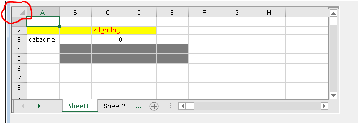

    Is it possible to set a text to the Column Header -1?

    You can use the SheetCorner property of the SheetView to access the corner of the sheet and then you can use the cells collection to get the cell of the sheet corner and set its value.
    Please refer to the sample attached.
