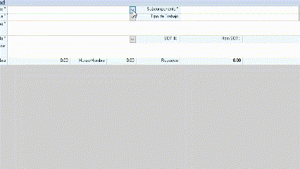

  • Posted 16 March 2022, 6:15 pm EST
    The spread version I am using is is 3.5
  • Posted 16 March 2022, 7:00 pm EST
  • Posted 21 March 2022, 7:09 am EST
    The version of Spread you are using is very old. Please update to the latest Spread.NET 15, the issue is not observed there.
