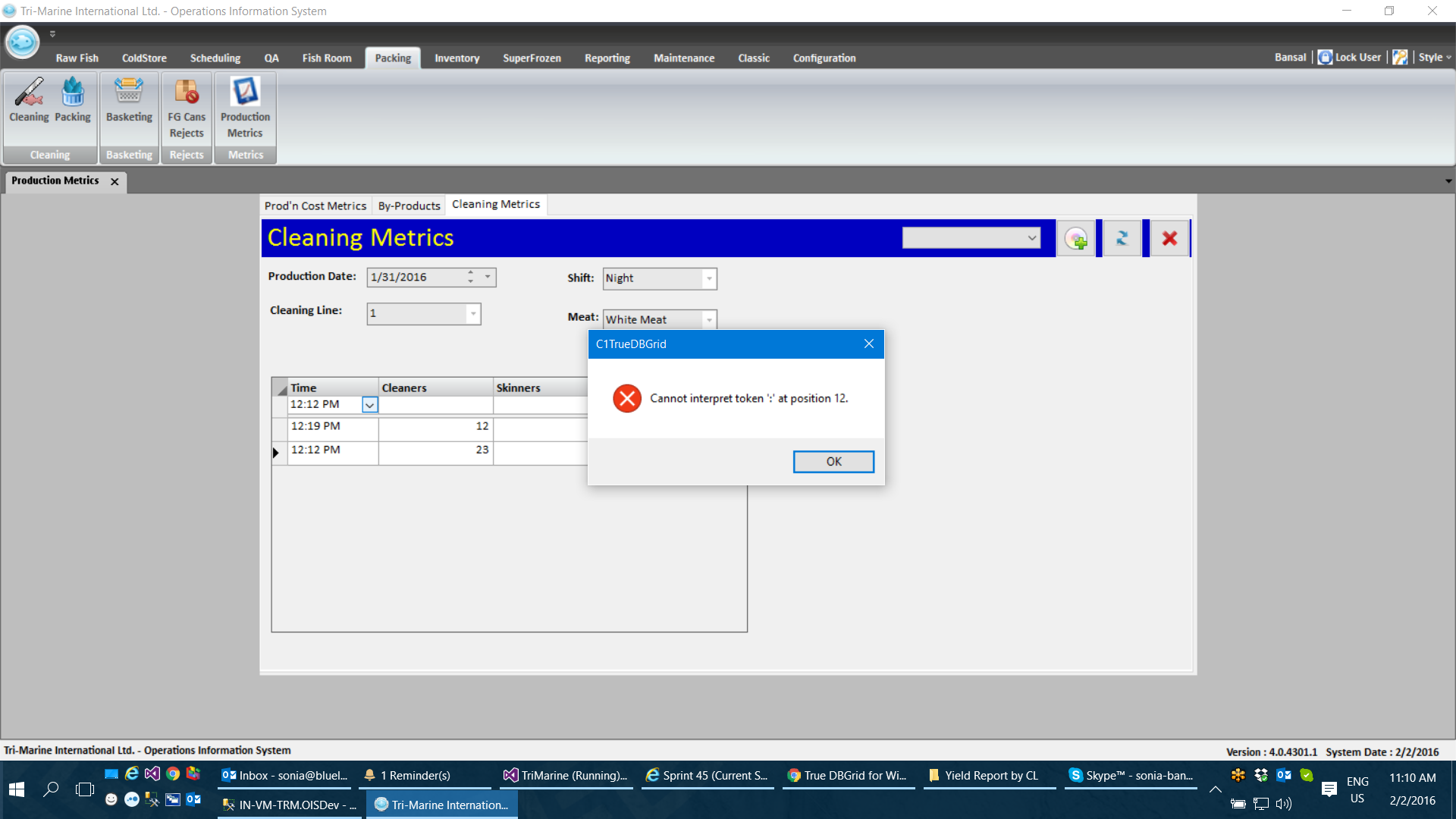

    True DB Grid need to show a time span column (hh:mm).
    Even though I have set the Number format of the column to Short Time, it considers column as “String” due to which on filtering below error is given -
    “Cannot interpret token “:” at position 12”.
    Snap shot attached

    Apologies for the delay in the response.
    We could replicate the issue at our end as well. We have escalated the issue to the development team and will let you know as soon as there is any update. Tracking id for the issue is: 144552.

    Right now, I have implemented a work around where I have set the column as date time and set Number Format as “Short Time” and applied custom format for the column during editing as “HH:mm”.

    This issue has been fixed in the latest release build which can be downloaded from here:
    http://prerelease.componentone.com/dotnet40/c1winforms/2017-T3/C1WinForms.4_4.0.20173.282.zip
