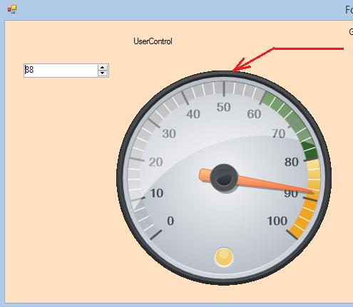

This problem is in your code, not in C1Gauge. When you get the image with c1Gauge1.GetImage() it
contains semi-transparent pixels at the border of the gauge. After changing value the OnPaint method draws the image once again but it doesn’t clear the previous image because of “SetStyle(ControlStyles.Opaque, true);”
When you paint semi-transparent pixels over and over they eventually become “black”.
If you remove “SetStyle(ControlStyles.Opaque, true);” the gauge starts to flicker each time when the value is changed because the UserControl fills its background with Form’s background color to simulate transparency.
To get rid of flickering you can add:
[csharp]SetStyle(ControlStyles.OptimizedDoubleBuffer | ControlStyles.AllPaintingInWmPaint, true);
[/csharp]to the constructor of UserControl2 and remove “g.Dispose();” from the OnPaint method because that’s a bug.
As the result of all those manipulations the first and second gauges will be drawn similarly, i.e. the button is still covered with either UserControl or C1Gauge.
