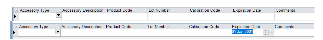

    I have a need to to set one cell as a datetime selection. To do this
            Me.TrueDBGrid.Splits(0).DisplayColumns(NameOf(class.value)).DataColumn.Editor = $DropDownHere
    If I were using a TrueDbDropDown I’d be able to use
            Me.TrueDBGrid.Splits(0).DisplayColumns(NameOf(class.value)).ButtonAlways = True
            Me.TrueDBGrid.Splits(0).DisplayColumns(NameOf(class.value)).DropDownList = True
    Those don’t seem to keep the drop down arrow though
    See the top screenshot where there is no dropdown under Expire, but in the lower when I click in there is a drop down?
    I like the appearance of the drop down for the date time better than the generic one i have in my first column that doesn’t fill the whole cell, but my primary concern is keeping a permanent drop down error even when cells are not selected.
    Thanks!

    Currently, there is no workaround to achieve the requested behaviour in the control.
    Be noted that on setting Editor property of a column in the grid, the user can see the control (or button in this scenario) when the cell is in edit mode.
    c1TrueDBGrid1.Columns("CategoryId").Editor = C1TrueDBDropdown1
    With the above code, setting ButtonAlways property does nothing.
    c1TrueDBGrid1.Splits(0).DisplayColumns("CategoryId").ButtonAlways = True
    And as you already know, on setting DropDown property along with ButtonAlways property, the user can see buttons without focusing the cell.
    c1TrueDBGrid1.Columns("CategoryID").DropDown = Me.C1TrueDBDropdown1
