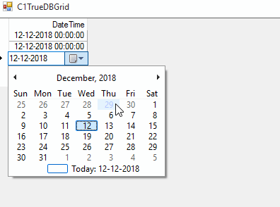

    Hi Horst!
    At my end, this works correctly and no such problem could be seen as demonstrated in the video.
    Can you please modify the attached sample so as to reproduce the mentioned error? Also, share your system environment details.
