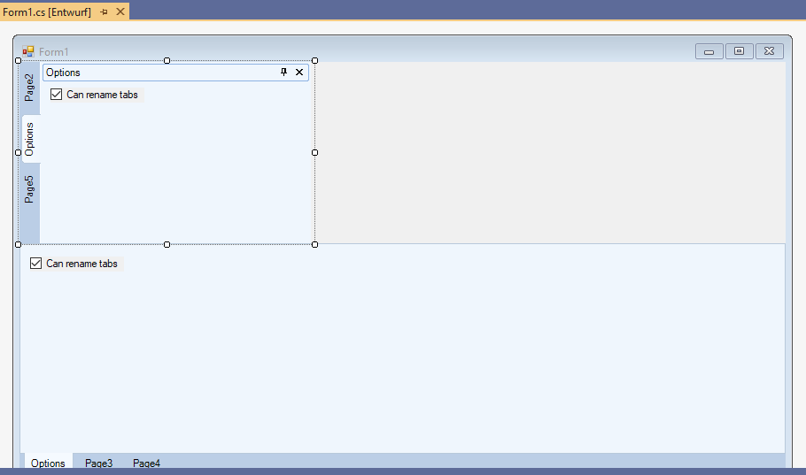

    After upgrading to Visual Studio 2019 I am no longer able to use the designer for a C1DockingTab.
    The designer opens and I can select the C1DockingTab but I cannot change tabs to make changes on other tabs but the first.
    I am able to reproduce this with the RenamingTabs-Example.

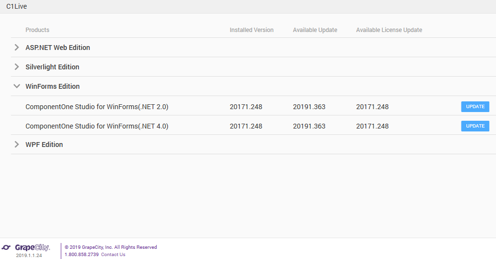

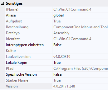

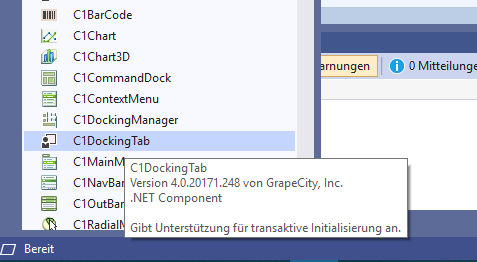

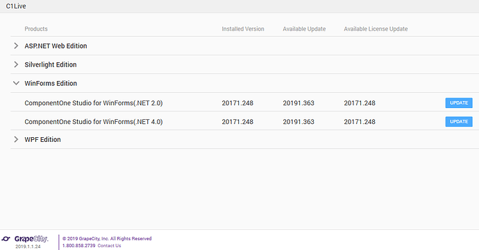

    Here are some screenshots to show the consistent usage of the same version.
    I tried to apply the tips from https://www.grapecity.com/forums/winforms-edition/unable-to-open-in-design-m#hiin-order-to-resolve-the- but to no avail.
