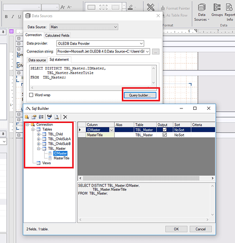

    1. Using C1FlexReportDesigner, you can use the “Query Builder” that helps you observe the structure based on the data source and thus, you can specify the data accordingly.
      However, DesignerApp sample at the default location “Documents\ComponentOne Samples\WinForms\C1FlexReport\CS” helps you work with the C1FlexReportDesigner via code.
      Further, you can bind a report at runtime, using the C1FlexReport instance, as shown in the basic sample that’s attached for your reference.
