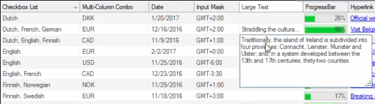

    I am working on a data and am using flexgrid. One of my columns consist of large data which cannot fit into the width of a flexgrid column. I am working for a way to view the content of this large data like the one in the image below.

  • Posted 6 October 2021, 3:46 pm EST
    Thanks it is working but the large text appears in one line irrespective of the length. I want the content to be in multi line like the image above
  • Posted 7 October 2021, 2:47 am EST
    You can use the C1Supertooltip and show the tooltip on the cells which have larger content than the area available. You can handle the MouseMove event of the flexgrid to set the tooltip and the popup event of the C1Supertooltip to set the location and maximum width of the tooltip.
    Please refer to the sample attached.
    Avnish
