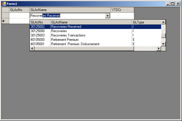

    If you type say “R” in the GLAcName combo it highlights the middle of the name so that you cannot do a progressive search properly. However the AcNo combo seems to work ok. I cannot figure out why.

    I spoke too soon, this is still something happening when you type “R”.

    The items that seem to behave oddly are those that have the letter appearing more than once in the words. If you type “R” you cannot type “e”, “t” to get the “Retirement” without first backspacing to the first “e”. Is it supposed to be like that? All other implementations I’ve come across work so that you can progressively type R, e, t.

    We too can replicate the issue in your mentioned builds i.e. v4.0.20151.38. Please see the attached gif “oldBuilds.gif”.
    When typing ‘r’ it searches first all the words started from “R” then put the cursor on the first word where “r” founds means does not ignore character case.
    As a workaround if you want to search words from ‘r’ from the first letter, type “R” in upper case then type ‘e’ and ‘t’ to get “Retirement”.
    It was a bug that gets fixed in the earlier builds. Please see the attached gif “latestBuilds.gif”.
