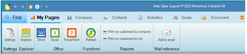

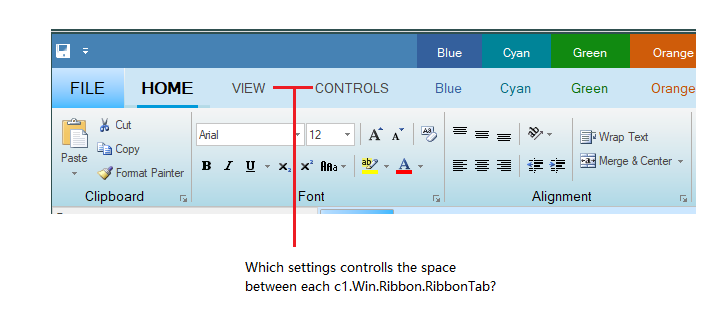

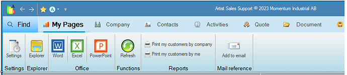

    Can you please help me, for some reason, the space between each ribbontab is to big.
    After the latest update of the controls. The last picture show how it looks in my application in designmode.
    Which setting(s) reflect the space between each tab?
    In C1ThemeDesigner(v4.8)
    How to set the space in code (vb.net)

    We compared the behavior of several older versions of C1Ribbon with the latest version and found them to be similar. The gap between the tabs appears unchanged in the latest version. Please see the attached sample project for reference.
    If you have a different layout that shows the issue, or if you are encountering the problem with any specific theme or setting, please update the sample project to reproduce the issue so we can investigate further.
