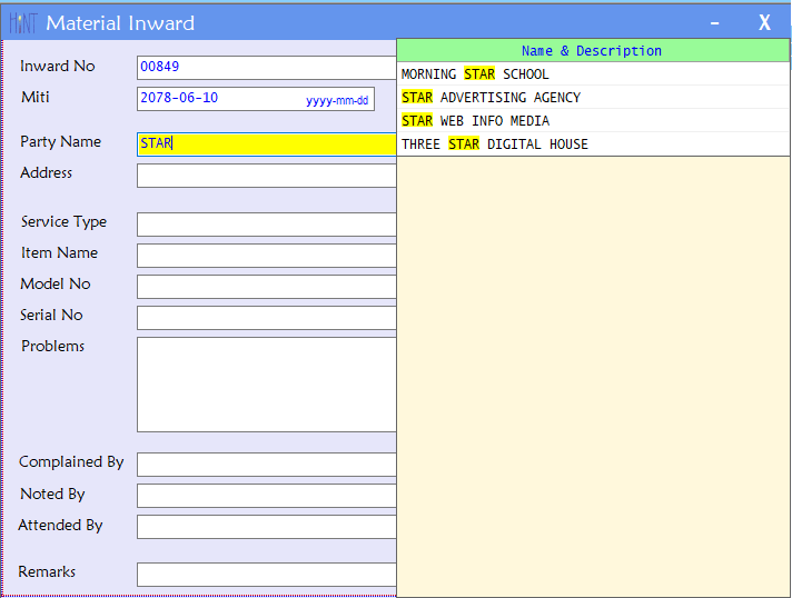

  • Posted 28 September 2021, 11:21 pm EST - Updated 3 October 2022, 10:44 pm EST
    Dear Prabhat Sir,
    Thankx. the overload worked…
    Please look into below image which has sorting problem…
    the image shows 4 rows containing “STAR” is ok…
    but it should sort the result by Begins with “STAR” First and Then Contains with “STAR”.
    result should be in below order…
    1. STAR ADVERTISING
    2. STAR WEB INFO MEDIA
    3. THREE STAR DIGITAL HOUSE
    4. MORNING STAR SCHOOL
    can we do so sir ?
    please suggest…
    Regards-
    Sanjeeb
  • Posted 29 September 2021, 5:41 am EST
    There is no direct way to achieve this kind of sorting behavior but you can develop your own custom logic to implement custom sorting:
    https://www.grapecity.com/componentone/docs/win/online-flexgrid/sort-operations.html
