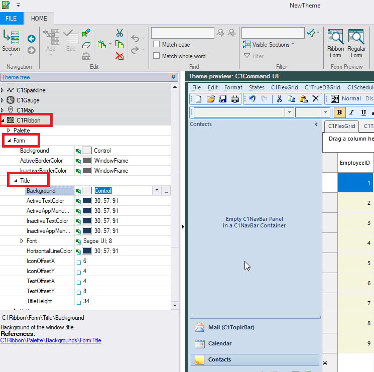

    Is it possible to customize the title bar of a form?
  • Posted 14 May 2020, 5:16 am EST - Updated 3 October 2022, 11:37 pm EST
    The built-in themes already customize the Form Title. You can see the ThemeDesigner application (located at “C:\Program Files (x86)\ComponentOne\Apps\v4.x”).
    As shown in the screenshot below, you can create a new theme to customize the Form title:
    Jitender
