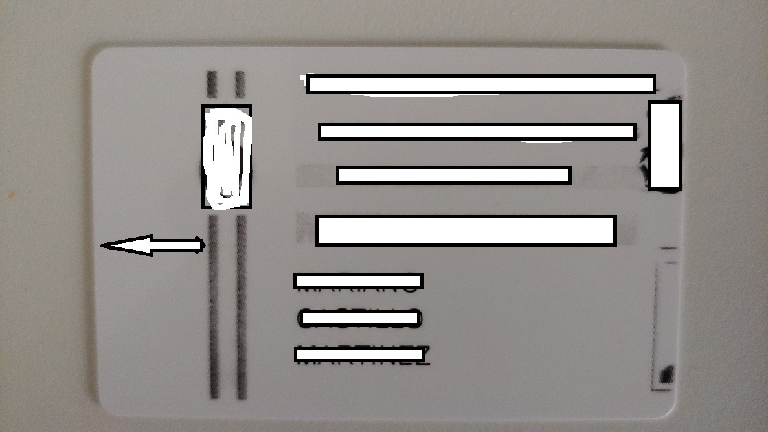

    Card report designed, indicated right, left, top and bottom edges to null, it doesn’t respect the left value.

    Got the same results, it shows a left edge which wasn’t the indicated.
    I would thank you to indicate me how to resolve this problem. Thanks
