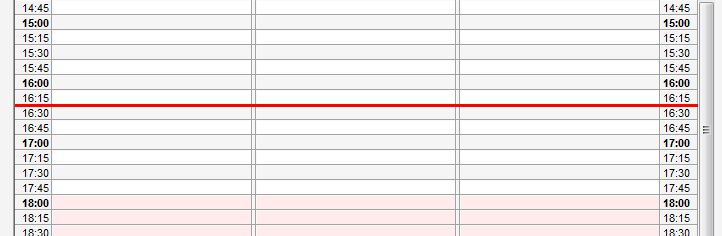

    I’m searching for a way to show the actual time as a colored line (example → attached file).
    Exists already for a specific property or how can I solve this with the C1 Scheduler? Unfortunately have not found anything in the documentation

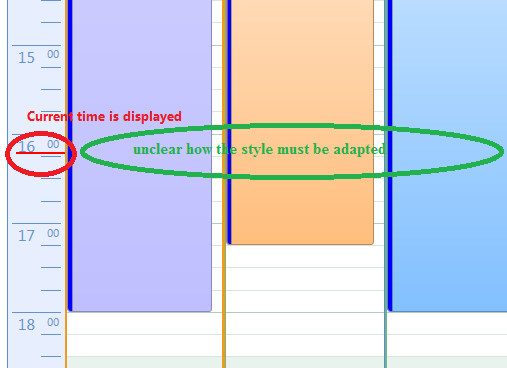

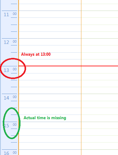

    Thank you for the example. It works so far, but confused me a couple of places:
    If I make the window wider so that the line has a width of more than 1061, then the line disappears? What is the reason?
    We then tried the line in our example (example in the Appendix, grouped in several days: the first day, second calendar) installed.
    In “OneDayStyle” the line is displayed but always at 13:00 (probably because of the reference in TimeRuler missing). In the “Working Week Style” the current time is displayed in TimeRuler, but it is still unclear to us how we must explicitly insert the line.
    We would be happy if we get here again a Tip

    I can’t check your xaml at runtime, as you use custom converter and I have no your code.
    So, just from reviewing your xaml:
    1. search your xaml for HourMarkersList - it’s old TimeRuler implementation, remove it.
    2. You placed TimeRuler inside ItemTemplate which is used to display individual data group. I’m not sure whether it works at all. If it is, it should show individual TimeRuler for every data group (if you set GroupBy=“Category”, you should see 2 time rulers). Do you need it?
    3. TumeRuler should be added to the parent Grid after all other child elements. It would make it on the top in z-order and current time line won’t be hidden under other elements. In your xaml it should be after next/previous Canvas.
    4. make sure that Scheduler actually uses your style, set Background in style to Red and check whether it works.
