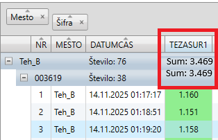

    Is there any way to acomplish this - i get error:
    System.InvalidOperationException: ‘Dispatcher processing has been suspended, but messages are still being processed.’
    grdPORABASUR_s.ItemsSource = l.OrderBy(Function(p) p.DATUMCAS).ToList()
    Dim g_list As New List(Of DataGridColumn)
    g_list.Add(colMESTO)
    g_list.Add(colKODAS)
    grdPORABASUR_s.GroupBy(g_list.ToArray)
    Dim g_sort As New List(Of DataGridColumn)
    g_sort.Add(colMESTO)
    g_sort.Add(colDATUMCAS)
    g_sort.Add(colNR)
    grdPORABASUR_s.SortBy(g_sort.ToArray)
    AddHandler grdPORABASUR_s.Loaded, Sub(sender, e)
                                          Dispatcher.BeginInvoke(Sub()
                                                                     DataGridAggregate.SetAggregateFunctions(colDATUMCAS, New DataGridAggregatesCollection From {
                                                                       New DataGridAggregateCount With {.ResultFormat = "Število: {0}"}
                                                                 End Sub)
                                          'Dispatcher.BeginInvoke(Sub()
                                          '                           DataGridAggregate.SetAggregateFunctions(colTEZASUR1, New DataGridAggregatesCollection From {
                                          '                               New DataGridAggregateSum With {.ResultFormat = "Skupaj = {0}"}
                                          '                       End Sub)
                                      End Sub
