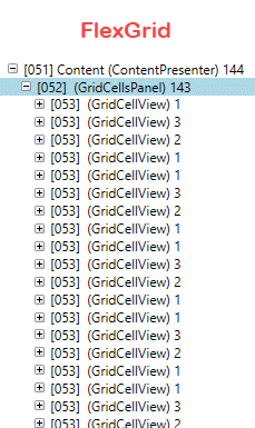

    This is the FlexGrid:

    JFYI, Flexgrid .Net 5 and C1DataGrid have different design architectures. i.e., DataGrid works with RowPresenters and Flexgrid .Net 5 uses CellFactory to display the CellView.
    So, sorry to inform you that, this is the design behavior of Flexgrid .Net 5. Hence it is not possible for .Net 5 Flexgrid to get RowPresenter.
