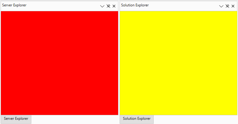

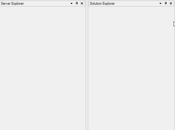

    We investigated the collapse behavior in WinForms and WPF C1DockControl based on your inputs and observed as below:
    If we have two-tab items say, Tab-1(Dock=Left) and Tab-2(Dock=Right) in the dock control. Dragging and docking the Tab-1 to the bottom of Tab-2 and then collapsing Tab-1, have different behavior in WPF and WinForms. (See Gif)
    In WinForms, on collapsing Tab-1, it docks according to the Parent’s docking state. i.e., after following the above steps, it collapses to the right, as Tab-2 was docked to the right.
    In WPF, on collapsing Tab-1, it docks according to its current docking state. i.e., after following the above steps, it collapses to the bottom, as Tab-1 was docked to the bottom.
    As per the discussion with the development team, WPF C1DockControl have appropriate behavior than WinForms. So, there will be no change in collapse behavior in WPF and is by design. Hence, you will only get the fix of Dock Resizing and Dock selected state issue in the next build.

    Here is a gif demonstrating the issues:
    When “Left 01” is docked to the LeftInnerPart of the C1DockTabControl that is docked on the Right side - it should collapse to the Right (Inherit from its new parent C1DockTabControl) - not on the left side or the parent C1DockControl - this makes no sense.
    This issue is the same for all situations when docking to any InnerPart (Right, Left, Bottom or Top) - it should always collapse as defined by the parent C1DockTabControl hosting the InnerPart you are docking to, as per the WinForms control.
