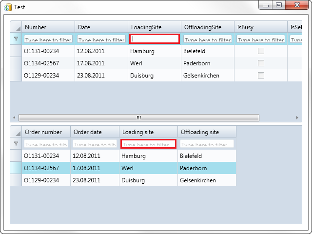

    Please see the attached sample application and screenshot.
    The Load method of the OrderList passes a special criteria object over the network to the application server. The DataPortal_Fetch method runs on the application server; the access to the database takes place there only. The application itself has no knowledge about / no direct access to the underlying database. (The attached sample is configured that it runs local without a database.)
    In my applications I create a special filter string and pass it to the server. Such a filter string would look like this:
    “[PropertyName1] > ‘Filtertext1’ AND [PropertyName2] = ‘Filterstring2’”
    When the user presses Enter in a filter textbox, I want to create this filter string, pass it over the network to the application server and reload the data from the database. It is not a “Filter the actual content of the grid” but a “Search the database for” scenario…
    The CSLA Framework throws an exception on the attempt of altering a read only business collection. This happens in my attached sample when you enter a text into the filter bar of the first grid: The grid tries to filter the list straightaway by removing items from the list – just after the first key has been pressed. Then it throws a “Filtering rows isn’t allowed” exception.
    Can I turn off this automatic filtering and handle the complete filtering by myself after the user pressed Enter? Like I can do in the C1TrueDataGrid? I can’t change the behaviour of my business objects, because they must work in a mixed WPF and Windows Forms application with new and old code.
    In the second grid of the sample I created the columns myself. There the filter bar is disabled and I can’t enter text at all.

    Currently the filter row commits the filter after a delay in order to avoid executing a filter operation for each key pressed event. I added a property named “Delay” which can be set to null to remove that feature, also now the filter row handles the enter key so that it filters when enter key is pressed.
    This changes will be available in the next bug-fix release.
    If you need more flexibility you could implement your own filter row or override the provided one.
    On the other hand when the columns are set in xaml you should specify the property FilterMemeberPath for each colmn in order to enable filtering.
