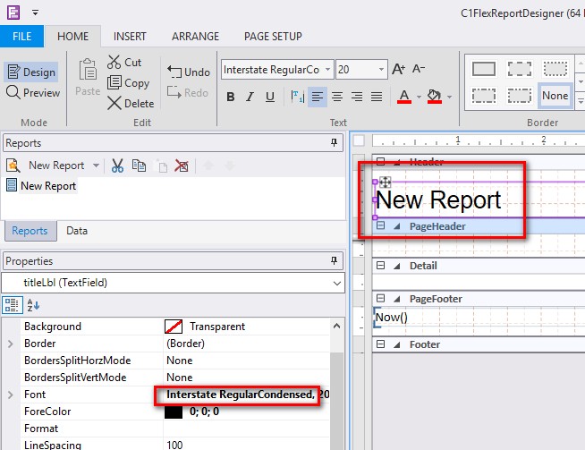

    we have a problem with C1FlexReport. A specific true type font “Interstate Regular Condensed” is not showing correctly, neither in the designer nor in the report itself.
    In the old version (C1Report) this worked.
    This is how it should look (picture 1).
    And how it shows (picture 2).

  • Posted 28 September 2018, 6:06 am EST
    Hello Nico,
    I could observe the issue at my end as well. I have escalated the same to the concerned team [Internal Tracking ID: 345234] and will get back to you once I receive an update.
    Please note that on selecting the particular field in the report (making it editable), I could observe that the font has been applied to the field, though its not visible.
  • Posted 1 October 2018, 5:15 am EST
    Hi Esha,
    thank you!
    I also noticed (like you wrote), that when selecting the field in the report, the font get’s applied, but it defaults back to Arial or whatever (I guess it loads the Windows default font) when rendering the report…
    Please keep me informed, we have to use this font for a specific customer.

  • Posted 19 November 2018, 7:13 am EST
    This issue is found fixed with the latest release builds.
    In order to verify the fix, please upgrade your ComponentOne version either using C1Live or downloading the latest builds from: http://prerelease.componentone.com/dotnet40/c1winforms/2018-t3/C1WinForms.4_4.0.20183.338.zip
    Apps folder from this download will contain the latest designer.
