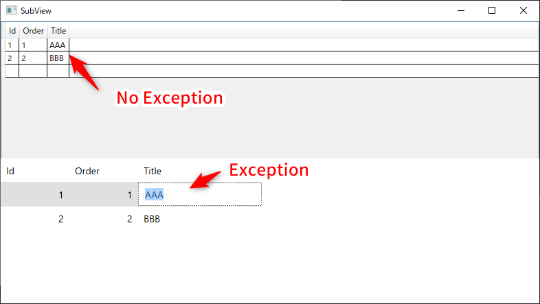

    Hello.
    C1.WPF.Grid.Ja 5.0.20212.110
    1 .Open SubView.
    2. When SubView is closed, Subview’s DataContext is set null.
    3. Reopen SubView.
    4.When editing a column,
    System.NullReferenceException: ‘Object reference not set to an instance of an object.’
    Would you fix?
