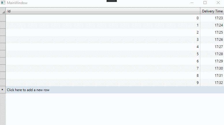

    We have set Width=“Auto” to the DataGridDateTimeColumn but we didn’t replicate this behavior at our end i.e., Column’s Width is constant.
    Please refer the attached gif for the same :
    Refer Modified Sample : DataGridDateTimeColumn_Mod2.zip

  • Posted 21 October 2021, 4:05 am EST
    Hello Nitin,
    You have set Width=“Auto”, but left Header=“Delivery Time”. Please change Header to “Time” and you will see what I mean.
    firelex
  • Posted 21 October 2021, 5:13 am EST
    I’ve got your point. Actually, this is the design behavior of Auto Width column, if cell content size increase, then column width will also increases. At the time of editing the cell content size is increasing that’s why Width of column is increasing as well.
