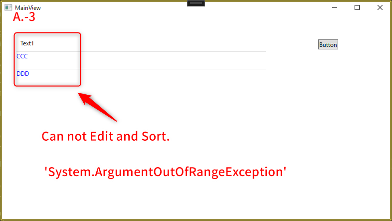

    Hello.
    Exception occures in these scenario.
    Could you fix?
    C1.WPF.Grid.Ja 6.0.20213.162
    .NET 6

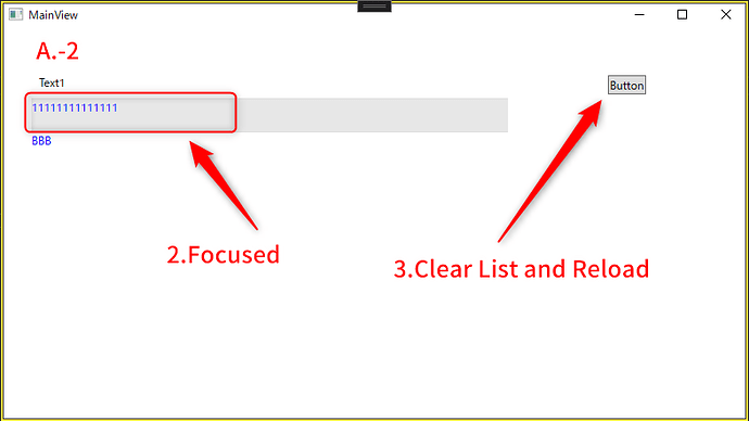

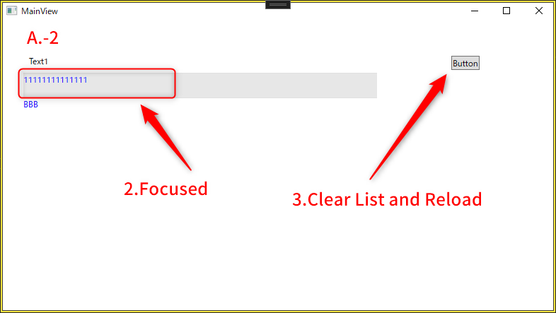

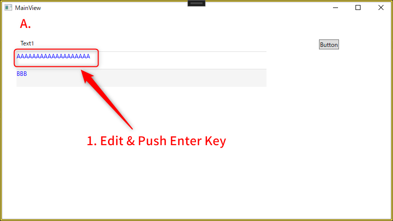

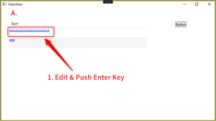

    A.
    1. Edit & Push Enter Key.
    2. Row is focused.
    3. Clear list

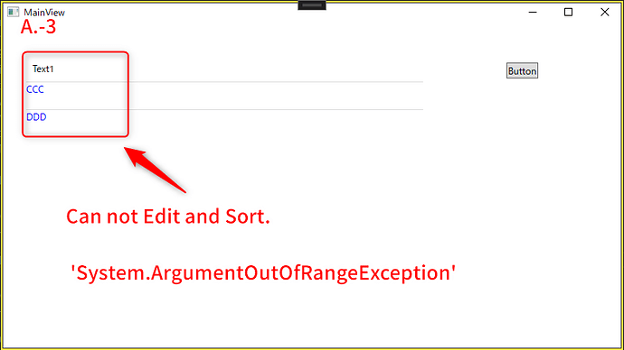

    4.Can not Edit & Sort. System.ArgumentOutOfRangeException occures

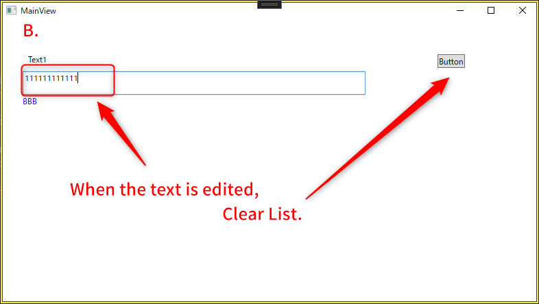

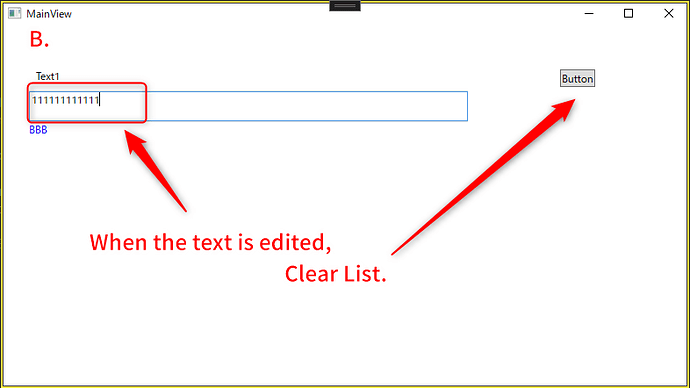

    B.
    1. TextBox is edited, and Clear List.
    2. Exception occures
    System.ArgumentOutOfRangeException: ‘Index was out of range. Must be non-negative and less than the size of the collection. Arg_ParamName_Name’

  • Posted 2 March 2022, 7:24 am EST
    Thanks for providing the sample and snapshots.
    You need to finish editing before modifying collection source of flexgrid. In your scenario, Collection is modifying without exiting from the edit mode.
    You can end edit before Reload as:
    	 grid.FinishRowEditing();
             _model.Reload();
    Please refer the attached modified sample for the same : FlexGrid_OutOfRange_Mod.zip
