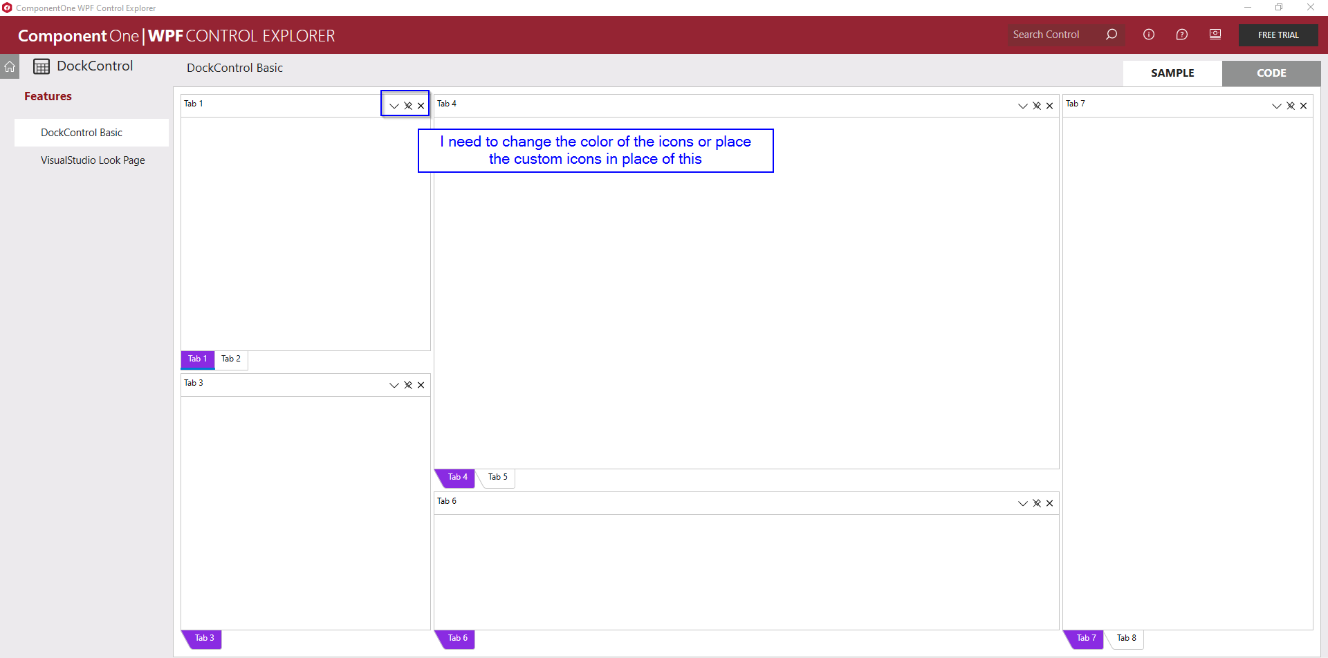

    Hello, I am looking to customize the C1DockTabcontrol icons (float, close).
    Is there any way I can place my custom Icons or change the color of the Icons in the C1DockTabcontrol.
    Please let me know.

    Hi Rambabu,
    You can fetch the C1DockTabControl icons by handling DockControl’s ViewChanged event. Th following code shows how to changed the backcolor of these buttons:
    private void DockControl_ViewChanged(object? sender, EventArgs e)
        var dockControl = sender as C1DockControl;
        if (dockControl != null)
            List<C1DockTabControl> tabControls = GetAllC1DockTabControls(dockControl.Items);
            foreach (var tabControl in tabControls)
                var dropDownButton = (tabControl.Template.FindName("9_T", tabControl) as C1DropDownButton);
                dropDownButton.Background = Brushes.Yellow;
                var pinButton = (tabControl.Template.FindName("SlidingButton", tabControl) as Button);
                pinButton.Background = Brushes.Yellow;
                var closeButton = (tabControl.Template.FindName("HiddenButton", tabControl) as Button);
                closeButton.Background = Brushes.Yellow;
    public static List<C1DockTabControl> GetAllC1DockTabControls(ItemCollection items)
        List<C1DockTabControl> tabControls = new List<C1DockTabControl>();
        foreach (var item in items)
            if (item is C1DockTabControl tabControl)
                tabControls.Add(tabControl);
            else if (item is C1DockGroup dockGroup)
                // Recursively call the function for C1DockGroup's items
                tabControls.AddRange(GetAllC1DockTabControls(dockGroup.Items));
        return tabControls;
    You can further explore the properties of these buttons and customize them as per your requirements. Kindly refer to the attached sample for full implementation. ( CustomizeDockTabIcon.zip )
