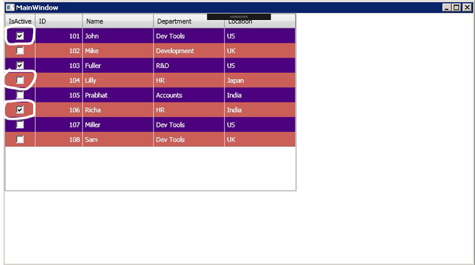

    In my project am trying to hide some checkboxes in Datagrid without effecting the background color based on some condition.
    Below image i would like to hide circled checkboxes with out effecting the Background color.

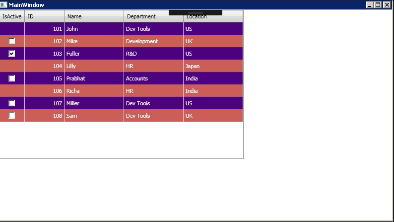

    Resulted Datagrid should be like this

    In order to hide the cell element, you can make use of C1DataGrid.LoadedCellPresenter event and toggle its visibility as per your condition:
    private void C1DataGrid_LoadedCellPresenter(object sender, C1.WPF.DataGrid.DataGridCellEventArgs e)
     if(e.Cell.Presenter.Content!=null && e.Cell.Presenter.Content is CheckBox)
      var chb = e.Cell.Presenter.Content as CheckBox;
      if((e.Cell.Row.DataItem as Employee).Department == "Dev Tools")
       chb.Visibility = Visibility.Collapsed;
    Please refer to the attached modified sample for the same. Also, for a variety of examples for C1DataGrid, you can refer to the “DataGridSamples” product sample from “Documents\ComponentOne Samples\WPF\C1.WPF.DataGrid\CS\DataGridSamples”.

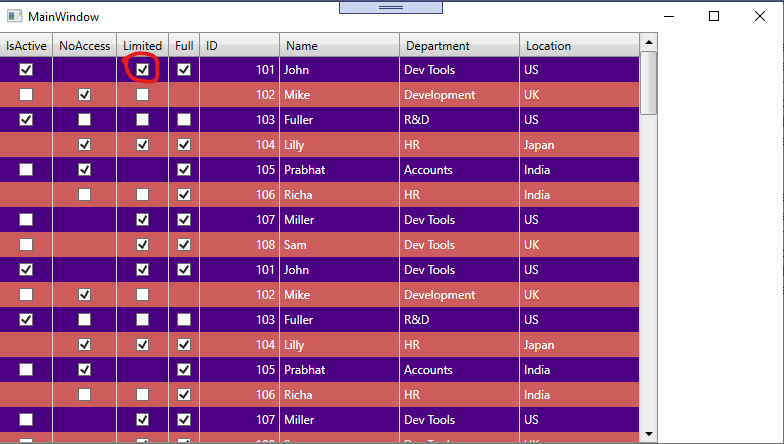

    In my case row count is more than 500 and every row having more than one checkbox column. I applied above logic but am facing two issues, when click on hidden checkbox area checkbox is showing and another issue is when scrolling continuously showing few check-boxes automatically.
    Grid View before scrolling :
    Grid View after scrolling :

    1. Regarding hidden Checkboxes being shown when clicked on the cell:
    Since we explicitly hide the cell content and cell clicks are handled by DataGrid (not knowing that cell element is hidden) to make a cell editable hence the behavior. To resolve this issue, you can handle the C1DataGrid.BeginningEdit event and cancel the edit if the cell meets some specified criteria.
    private void C1DataGrid_BeginningEdit(object sender, C1.WPF.DataGrid.DataGridBeginningEditEventArgs e)
     if(IsCellSatisfyingCondition(c1DataGrid[e.Row, e.Column]))
      e.Cancel = true;
    2. Regarding Scrolling issue:
    C1DataGrid reuses the cell elements for better performance. So, we also need to set the checkboxes’ visibility back to visible if the cell does not meet the specified criteria.
      chb.Visibility = IsCellSatisfyingCondition(e.Cell) ? Visibility.Collapsed : Visibility.Visible;
    Please verify the above with the attached modified sample.

    Thanks a lot now working fine.
