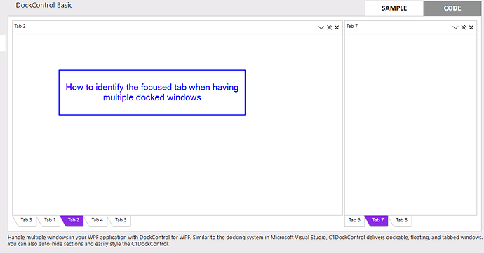

    I am looking to find the last focused tab when having multiple docked windows, as shown in the screenshot below.
    For instance, suppose I have 5 tabs within DockedWindow1 and 3 tabs within DockedWindow2. If my most recent interaction was with Tab 7 in DockedWindow2, I’d like to be able to identify the current active DockedWindow.
    Can you please let me know how to achieve this?
