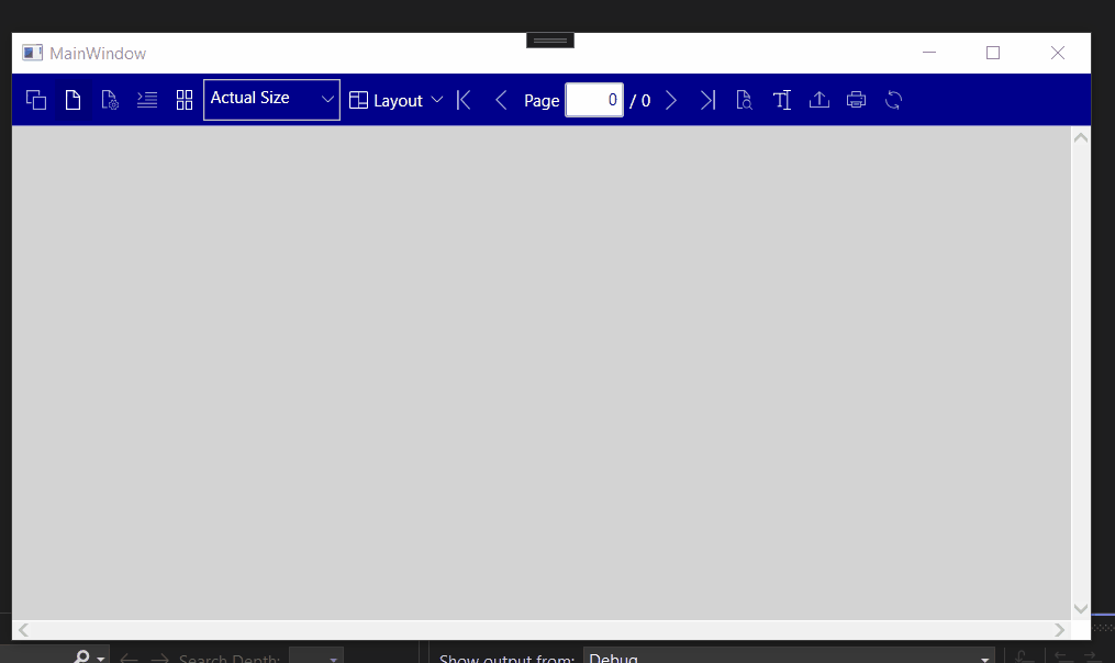

  • Posted 18 September 2023, 12:24 pm EST - Updated 18 September 2023, 12:29 pm EST
    Aastha,
    This got me a lot closer, but the code to change the page number textbox background and foreground didn’t work along with the following that needs to be changed:
    *Zoom Options combobox and dropdown
    *The Layout Options combobox dropdown
    I have attached a new photo with the issues
  • Posted 18 September 2023, 1:25 pm EST - Updated 18 September 2023, 1:30 pm EST
    Adding screenshot of Zoom Options combo dropdown wrong colors

  • Posted 19 September 2023, 1:58 pm EST
    I created a test application that behaved as yours did, however, probably due to the xaml styles for our application, the foreground for the dropdown for the Zoom Options is still white against a white background. Even if it was black as in your example, it wouldn’t be acceptable because the background for the Zoom Options dropdown is white, while the background for the Page Layout Options can be changed to our dark blue. Not professional.
    It is really disappointing that color scheme for the C1 controls cannot be modified in a professional manner to match an applications custom color scheme.
    I’ll have to just implement my own toolbar for the viewer.
