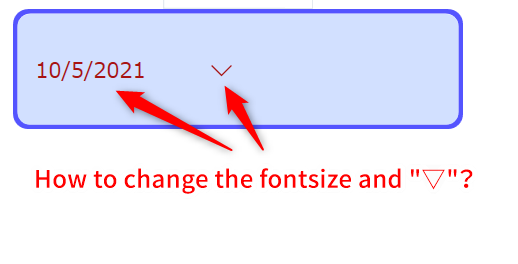

    Hello.
    C1.WPF.Input.Ja 5.0.20212.110
    How to change the fontsize and the dropdown button size?
    The FontSize Property does not work. Is this a bug?

    Thank you for providing the snapshot.
    1. This behavior is bug, and we escalated this behavior with the development team. We’ll get back to you once we have any update.[Internal Tracking Id: C1XAML-28248]
    However, as a workaround you can set FontSize of C1MaskedTextBox inside it. You can find C1MaskedTextBox from C1DatePicker’s template and then you can easily set FontSize on C1MaskedTextBox as :
    private void DatePicker_Loaded(object sender, RoutedEventArgs e)
                var dtPicker = sender as C1DatePicker;
                var txtBox = dtPicker.Template.FindName("TextBox", dtPicker) as C1MaskedTextBox;
                txtBox.FontSize = 24;
    1. For ToggleButton’s content size, you need to handle Loaded event of C1DatePicker and find the toggle button from its template. Now you can set toggle button’s content size accordingly.
      JFYI, fontsize will not work on toggle button, because toggle button have path in its content. (see code snippet)
                var button = dtPicker.Template.FindName("Button", dtPicker) as C1ToggleButton;
                (button.Content as ContentControl).Height = 20;
                (button.Content as ContentControl).Width = 20;
    Please refer the attached sample for the same : C1DatePickerFontSize.zip
