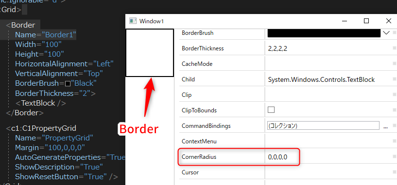

    Hello
    C1.WPF.PropertyGrid.Ja 5.0.20212.110
    When editing the ConerRadius Property, System.InvalidCastException occures.
    Would you fix?
  • Posted 29 October 2021, 7:49 am EST
    Thanks for the snapshot.
    We have replicated this issue at our end, and it seems like a bug. So we have escalated this to the development team. We will get back to you once we have any update. [Internal Track Id - C1XAML-28294]
