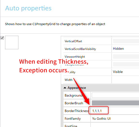

    Hello
    C1.WPF.PropertyGrid.Ja 5.0.20212.110
    When editing Thickness, Exception occurs.
    ex: Deleting a number or else
    Would you fix?

    Thank you for providing the snapshot.
    We have replicated this issue at our end and it seems like a bug. So, we have escalated it to the devs. We will get back to you once we have any update. [Internal Tracking Id - C1XAML-28177]

  • Posted 7 December 2021, 6:08 am EST
    We are happy to inform you that this issue has been fixed with the latest build 2021v3.
    So, we would request you to upgrade to the latest build using ComponentOne control panel. Just in case if you don’t have ComponentOne Control Panel, you can download it from https://www.grapecity.com/componentone/download.
