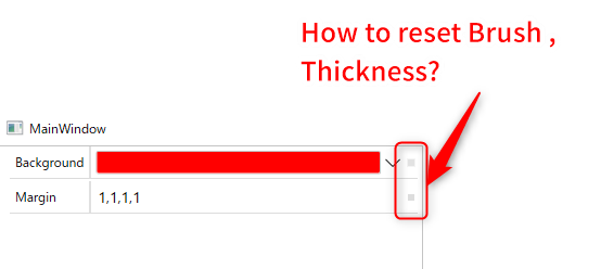

    How to reset Brush to Null?
    How to reset Thickness to 0,0,0,0?

    In order to reset property values to default on ResetButton click, you need to handle PropertyReset event of C1PropertyGrid as :
    private void Property_Reset(object sender, PropertyBoxChangedEventArgs e)
                var memberName = e.PropertyBox.PropertyAttribute.MemberName;
                if (memberName == "Background")
                    (e.PropertyBox.CurrentEditor as BrushEditor).SelectedBrush = (Brush)e.PropertyBox.PropertyAttribute.DefaultValue;
                else if (memberName == "Margin")
                    (e.PropertyBox.CurrentEditor as TextBox).Text = e.PropertyBox.PropertyAttribute.DefaultValue.ToString();
    Please refer the attached modified sample for the same : PropertyGridStudy20211011_Mod.zip

    Thank you for your help. It works.
